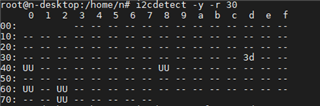

    root@n-desktop:/home/n# i2cdetect -y -r 30
    0 1 2 3 4 5 6 7 8 9 a b c d e f
    00: -- -- -- -- -- -- -- -- -- -- -- -- --
    10: -- -- -- -- -- -- -- -- -- -- -- -- -- -- -- --
    20: -- -- -- -- -- -- -- -- -- -- -- -- -- -- -- --
    30: -- -- -- -- -- -- -- -- -- -- -- -- -- 3d -- --
    40: UU -- -- -- -- -- -- -- UU -- -- -- -- -- -- --
    50: -- -- -- -- -- -- -- -- -- -- -- -- -- -- -- --
    60: UU -- UU -- -- -- -- -- -- -- -- -- -- -- -- --
    70: -- -- UU -- -- -- -- --

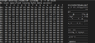

    root@n-desktop:/home/n# i2cdump -y -f 30 0x3d
    No size specified (using byte-data access)
    0 1 2 3 4 5 6 7 8 9 a b c d e f 0123456789abcdef
    00: 7a 00 1e 20 df 01 00 fe 1c 10 7a 7a 83 09 08 7f z.? ??.???zz????
    10: 00 00 00 00 00 00 00 00 00 00 00 00 00 00 04 02 ..............??
    20: 30 01 00 00 00 00 00 00 00 00 00 00 00 00 00 00 0?..............
    30: 00 00 00 00 40 00 00 00 00 00 00 01 14 6f 00 40 ....@......??o.@
    40: 00 a7 71 01 00 00 00 00 00 00 00 12 00 13 04 64 .?q?.......?.??d
    50: 00 00 00 03 02 00 00 00 1e 00 00 30 00 00 00 00 ...??...?..0....
    60: 00 00 00 00 00 00 00 00 00 00 00 00 00 7c 88 88 .............|??
    70: 2b 2c e4 00 00 00 00 c5 00 01 00 00 20 00 00 00 +,?....?.?.. ...
    80: 00 00 00 00 00 00 00 00 00 00 00 00 00 00 00 00 ................
    90: 00 00 00 00 00 00 00 00 00 00 00 00 00 00 00 00 ................
    a0: 02 0f 00 00 08 18 00 00 00 00 00 00 00 00 00 00 ??..??..........
    b0: 08 14 3f 08 25 00 18 00 fc 33 83 74 80 00 00 00 ????%.?.?3?t?...
    c0: 00 00 00 00 00 00 00 00 00 00 00 00 00 00 00 00 ................
    d0: 00 43 94 02 60 f2 00 00 00 00 00 00 00 00 00 00 .C??`?..........
    e0: 00 00 00 00 00 00 00 00 00 00 00 00 00 00 00 00 ................
    f0: 5f 55 42 39 35 34 00 00 00 00 00 00 00 00 00 00 _UB954..........

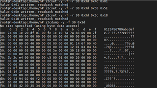

    root@n-desktop:/home/n# i2cset -y -f -r 30 0x3d 0x4c 0x03
    Value 0x03 written, readback matched
    root@n-desktop:/home/n# i2cset -y -f -r 30 0x3d 0x58 0x5E
    Value 0x5e written, readback matched
    root@n-desktop:/home/n# i2cset -y -f -r 30 0x3d 0x58 0xdE
    Value 0xde written, readback matched
    root@n-desktop:/home/n# i2cset -y -f -r 30 0x3d 0x5c 0x18
    Value 0x18 written, readback matched
    root@n-desktop:/home/n# i2cdump -y -f 30 0x3d               (From value of register 0x04, I can see that lock is achieved)
    40: 00 a7 71 01 00 00 00 00 00 00 00 12 03 03 04 64 .?q?.......????d
    50: 00 00 00 03 02 00 00 00 de 00 00 30 18 00 00 00 ...??...?..0?...

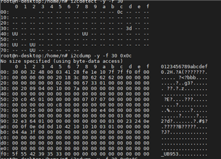

    00: -- -- -- -- -- -- -- -- -- 0c -- -- --
    10: -- -- -- -- -- -- -- -- 18 -- -- -- -- -- -- --
    30: -- -- -- -- -- -- -- -- -- -- -- -- --3d -- --
    50:-- -- -- -- -- -- -- -- -- -- -- -- -- -- -- --

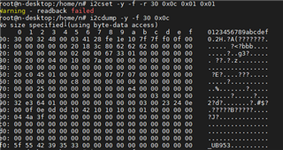

    root@n-desktop:/home/n# i2cset -y -f -r 30 0x0c 0x01 0x01
    Warning - readback failed
    root@n-desktop:/home/n# i2cset -y -f -r 30 0x18 0x01 0x01 (Unable to reset 953)
    root@n-desktop:/home/n# i2cdump -y -f 30 0x18
    00: 30 00 32 48 00 03 41 28 fe 1e 10 7f 7f 0c c0 00 0.2H.?A(???????.
    10: 00 00 00 00 00 20 18 3c 80 62 62 62 00 00 00 00 ..... ?<?bbb....
    20: 00 00 00 00 00 02 00 00 67 33 01 00 00 00 00 00 .....?..g3?.....
    30: 00 20 09 04 00 10 00 7a 00 00 00 00 00 00 00 00 . ??.?.z........
    40: 00 00 00 00 00 00 00 00 00 00 00 00 00 00 00 00 ................
    50: 20 c0 65 00 00 00 00 00 07 07 07 00 00 00 00 00 ?e.....???.....
    60: 00 00 00 00 00 c8 00 00 00 00 00 00 00 00 00 00 .....?..........
    70: 00 00 25 00 00 00 00 00 00 01 e4 00 00 00 00 00 ..%......??.....
    80: 00 00 00 00 00 00 90 00 00 00 00 00 03 00 00 00 ......?.....?...
    90: 32 e3 64 01 00 00 00 00 00 00 00 03 00 23 24 0e 2?d?.......?.#$?
    a0: 00 0f 0e 0d 0d 10 42 10 10 10 03 01 00 00 00 00 .?????B?????....
    b0: 04 4a 3f 00 00 00 00 00 00 00 00 00 00 00 00 00 ?J?.............
    d0: 00 00 00 00 00 00 00 00 00 00 00 00 00 00 00 00 ................
    f0: 5f 55 42 39 35 33 00 00 00 00 00 00 00 00 00 00 _UB953..........

    Send reset signal to TI953
    Check the register dump of 0x18, Value of 0x0d did not go back to its original value of 0xf0, and is yet has the value that I set as 0x00
    00: 30 00 32 48 00 03 41 28 fe 1e 10 7f 7f 00 0f 00 0.2H.?A(?????.?.
    50: 20 c0 45 01 00 00 00 00 07 07 07 00 00 00 00 00 ?E?....???.....
    70: 22 00 25 00 00 00 00 00 00 00 e4 00 00 00 00 00 ".%.......?.....
    Can you please provide me more details on why the reset command fails.
