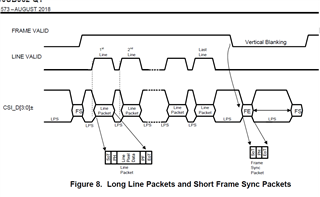

My customer is asking if there is any way to change the LPS time for UB962?
Please let me know if you any advice, thanks.

Hi James,
The LPS time is determined based on your input and output rate. This should not be changed in order to maintain the correct sensor parameters (resolution, blanking, frame rate, etc.).
