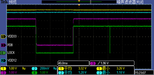

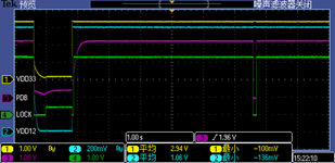

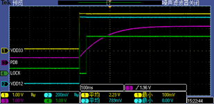

Hello Team,
Could you let me know how to detect 940 CSI pass condition as well as any SOT/data errors? I want to reset the CSI PLL by forcing unlock and lock.
Background: customer use 949+940, they meet low probability distortion issue when power up, can't recover automatically.
1. 940 lock keep high, disconnect and reconnect cable will recover (FPD-Link signal disconnected and reconnect only, keep system power)
2. Check 949 and 940 power sequence---good
I suspect it's CSI PLL issue but i need to do more test to verify.
Thanks.
