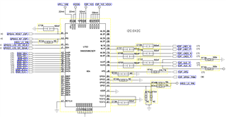

SN65DSI86: The signal AUX is not working,How are the registers for AUX configured,Apply to different screens
Part Number: SN65DSI86

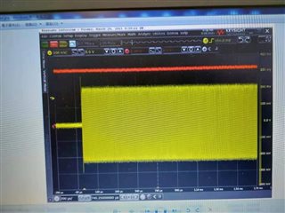

Now there are two screens connected with SN65DSI86, A can light up the screen, B can not light up the screen,
The detection found that the signal AUX was not connected, what could be the reason?
In addition, how to configure the AUX registers?
Thanks!
