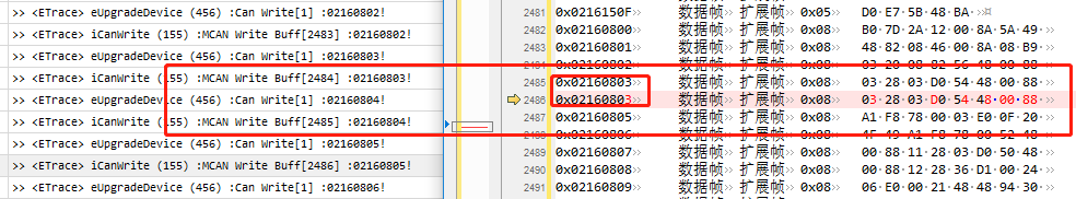

My customer is testing CANBUS transmission function and find a issue as below.
Sending out a series of  continuous CAN ID per 20mS, sometimes one of CAN IDs goes wrong and this CAN ID data is same as previous one.
EX : customer send out 0x021608010x021608020x0216080030x021608040x02160805 by SPI but capture CANBUS data then the date becomes 0x02160801,0x02160802,0x021608003,0x02160803,0x02160805。
Customer use SPI "TCAN4x5x_MCAN_WriteTXBuffer()" send correct CAN ID but the data in CANBUS is wrong like below.
(left side is log data, right side is CANBUS data captured at CANBUS differential line)
Cound team provide command and any experiment we can try?

  • Vincent,
    Is it possible to capture the CAN bus waveforms when they are correct vs. not correct? And can the interrupt register (0x0820) be read before and after a transmission?
    Eric Hackett
  • Hi Eric,
    Since it is a sequence of data transmission, customer is hard to capture the wrong one of the waveforms. We will continue to try it.
