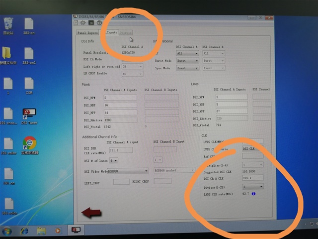

    3.When we use DSI tnner tool to configure parameters, there is no calculation icon in the lower right foot as in the video, and the output page cannot be opened. just like the picture.
    Chen.Lu
  • Hi Chen,
    1. In test pattern mode the device does not use any input DSI data. It only uses the DSI CLK or optionally an external REFCLK. The clock is used to internally generate the pattern and output it to a display
    2. Step 2 and step 8 do not need to be followed in test pattern mode
    3. You can try this version of the tool instead: https://tidrive.ext.ti.com/u/5B25JYQduSH2Hbkl/DSI%20Tuner%202.1.zip?l
    I.K.
