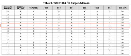

  • Hi Malik, so i got a USB-ISS device instead for using as a I2C master and wasn't sure about the commands to send. I couldn't find a DEVICE_ID register in the TUSB1064 datasheet. also what address would i use to address this IC? Do you have a whole hex command example i can send to it to read the state, with address, register r/w?
  • Hi Nikolay,
    TUSB1064 has many I2C address that can be configured from the SSEQ0/A0 and DPEQ0/A1 pins. Table 9. TUSB1064 I 2C Target Address will give you the 7 bit address to be used. It will be easiest to place the part in I2C mode via I2C_EN = 1 and leave A0+A1 in there default positions (pulled up, pin 2-3 connected) to use address 0x0F (7bit address). You should be able to read register 0x00.

  • Not getting any response to any commands. I tried reading from a few different addresses: 0x0F, 0x1F but still no response even when trying to read from registers 0x00, 0x0A and a few other registers shown on the datasheet.
  • Hello Nikolay
    1. If you remove R41,R44. then soldering R3,R5 and other is keep default config . I think you can use 0x42 device address to communicate with TUSB1064 chip. Concurrently you can use 0x7E device address to communicate with TPS65986 chip.
