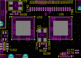

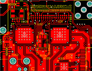

    Does the hub have a good thermal pad connection with adequate solder paste?

    I've also attached screenshots of the top paste layer with the silkscreen as well as an additional screenshot with the top layer.

    Let me know if there's anything else you'd like to see in more detail.

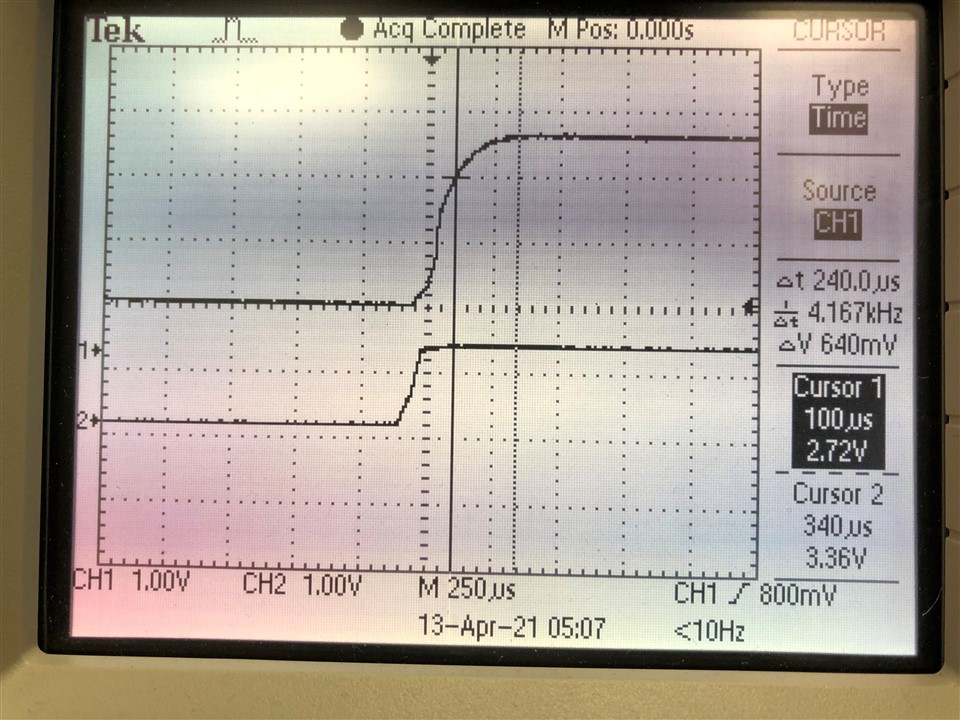

  • I scoped the power on timing of the 1.1 (1.2 in my case) and 3.3 rails.  See screenshot below.  Its hard to decipher exact timing, but 1.1 is stable approximately 240 usec before 3.3.  All I could really find in the datasheet is that 1.1 should be stable a minimum of 10 usec before 3.3.
    Working on your second question.  I believe its just the downstream devices that disappear momentarily, but trying to reproduce failure.  Now that I want to see a failure, the system seems to be holding strong though.  Will update with further info.
  • Hi Jason,
    I think your power on reset timing is ok.  You would see an issue at first connection if there was a reset timing issue, not after actively running for awhile.  I was more interested to see if there was noise on the 1.1V and 3.3V rails that could be causing the devices to drop off the bus.  Power consumption can vary quite a bit during active use so if there isn't enough bulk capacitance on the rail it could get noisy.
