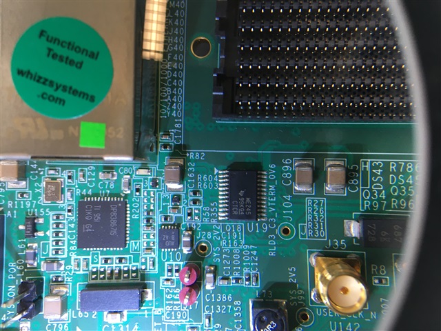

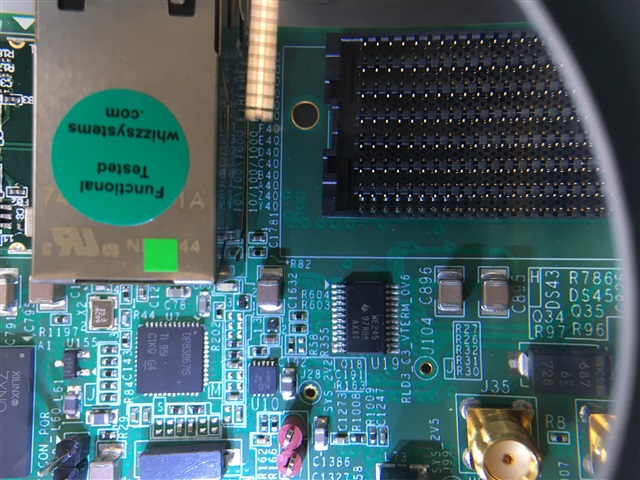

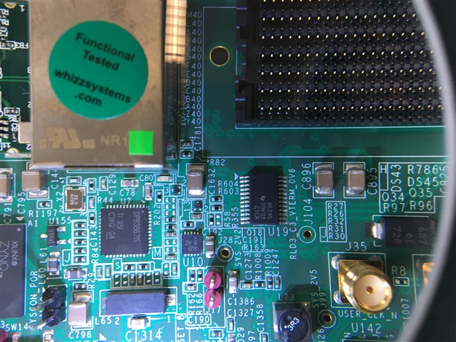

DP83867IS: Still SGMII Problem with different chip revisions
Part Number: DP83867IS
The issue from my original post "DP83867IS: SGMII Problem with different chip revisions" is still open. In the meantime, I managed to get access to all PHY registers.
Regarding @Nikhil Menon's question from Feb 23: I accessed register 0x0001 on all devices and all 5 devices respond with 0111 1001 0110 1101, which implies that the auto-negotiation process is completed and that a valid link has been established.
Still, only one of the devices is reachable via UDP (all running the same bitstream). Which registers should I investigate now?
Thanks and best,
Nico
  • Hello Nico,
    I suggest you to open the earlier ticket/post again and share the progress. That will help Nikhil know about the update and he can take it forward from there.
    Vikram
  • Hi Vikram,
    that would be great! How can I unlock the other post?
    Nico
  • If somebody is interested, I have attached bulk readouts of registers 0x0000 to 0x01D5 in ascii format for all 5 devices (D1-txt to D5.txt). Each file contains the content of the registers in hex and binary format (for convenience). D1-D4 are together on the same switch, D5 is connected directly to a secondary network device of a linux workstation. D1 ist the only device that can be reached via UDP, D2-D5 never answer to UDP packets. It would be great if somebody can find a hint for why this happens in these data files.
    Thanks and best,
    Nico

  • Here are pictures of all 5 boards. TI.Board1.JPG works. The other four boards do not work. Note that those have a different marking on the TI chip.This boards worksthis does not workthis does not workthis does not workthis does not work
