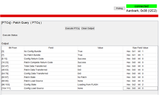

Hi, I have 3 TPS65987D on a custom board and I had set them each to go for Configuration 5 where it will sink 20V and source 5V but I'm not getting that negotiation to work.  I thought it was a programming issue, so I hooked up my aardvark to the i2c and spi flash to program the chip and swapped ADCIN so it would wait infinitely for the spi flash, but no dice. I would think it was something on the board, but when I go into debug mode in the TPS gui, any commands I send get a CMD_REJECTED response.  I'm using a RAVPOWER 65W USB PD wall charger.

  • I replaced my resistors so the device boots into PTCH mode.  I thought I programmed the flash but I'm getting this error when I try to change settings while in debug mode:

  • also getting this in patch query:
  • Typical of me.  I put the tps65987 in EC infinite wait and I don't have my mcu sending any commands
