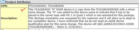

TS3USB3000: Why is the device marking on TS3USB3000MRSER and TS3USB3000RSER different
Part Number: TS3USB3000
my customer understands that the difference between TS3USB3000MRSER and TS3USB3000RSER is the tape and reel information
However he is suspicious whether there are other differences because the device marking is also different. This would not be needed if it was just the orientation in tape and reel.
