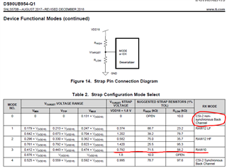

Hi Team, I have a question about DS90UB954-Q1 MODE setting, and need you help to confirm.

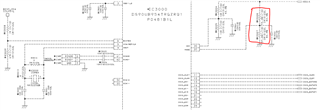

Now I‘m using this design to catch a video data as 30fps YUV422,mipi 2-lane data, and video data can be successfully locked.
But my MODE setting is RAW10, so is this MODE also can compatible with MIPI-CSI data?
Compared with datasheet, I think CSI-2 nonsynchronous Back Channel is correct MODE, so I take away pull-up resistor R3006, and video data can be successfully locked too.
So I want to confirm which MODE is recommend? Thanks.
