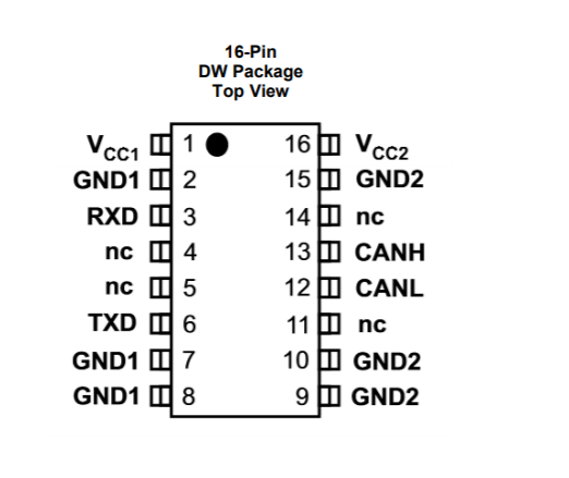

From ISO1050 datasheet, we can see that recommended Vcc2 range is 4.75-5.25V. But according to experiment, ISO1050 can work normally when the Vcc2 drops to 4.0V. So my question is what the Vcc2 maximum and minimum are for ISO1050 working normally. How do you get the Vcc2 range(4.75-5.25V)? And what is the potential risk if ISO1050 works below 4.75V(Vcc2) continuously?

Proper operation of the ISO1050 is not guaranteed outside of the Recommended Operating Conditions. These limits are determined to be the part's physical environment necessary to perform as specified. Although the device may appear to function outside of the recommended Vcc2 level, it is not characterized to meet datasheet specifications outside of recommended voltages, and it could be damaged.

It is not abnormal for you to see the ISO1050 working down to 3.5V. That being said, we cannot guarantee any of the electrical characteristics or switching characteristics outside of the recommended operating conditions. So your customer would be doing so at their own risk.
