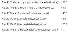

Hi Team
What is the Maximum Junction Temperature (TJ) and the Junction-to-Case Thermal Resistance (θJC) for 5962-8762402VDA? I'm not seeing these values listed in the data sheet.

Hi William,
I will submit a thermal request in. These usually have a turn around time of 2 weeks. I will respond to this thread when I get the information.

Hi William,
Junction temperature can actually be found by referring to this FAQ: What is the maximum junction temperature (TJMAX) for a device?.
For your device it will be 150C. However, θjc will still need to be found through the thermal request. I have sent in a priority request and I will update you whenever this information comes in.
Hi Wililam,
These are the results requested. Temperatures will be will C
