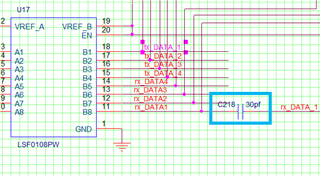

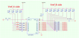

I learned that LSF0108 supports both push-pull and open-drain mode output, my question is:
1) If I add external pullup resistor on one I/O port, so what's the output mode now? push-pull or open-drain and why?
2) If the I/O(output) port mode has relationship with the peripheral part's I/O(input) mode?
