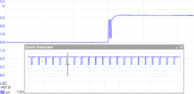

In my project using a level shift chip(MPN: TXB0104). Occure a issue on the lab test. The rise/fall edge nonmonotonic when input the squre wave.
Could you give me some suggest?

The schematic is incomplete.
Anyway, the TXB has very weak output drivers and does not work with a capacitive load, i.e., with long traces, connectors, or cables.
If the signals are not actually bidirectional, use a buffer translator from the TXU series.
