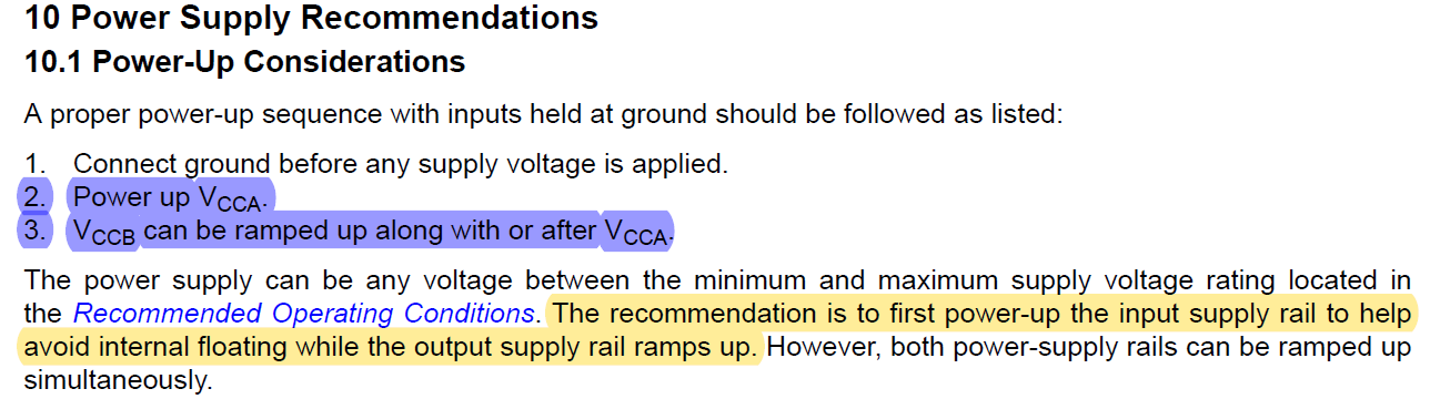

(1)The data sheet has the following description for the power-on sequence, but what kind of problems can be expected if this is not followed? Could you please tell me it? They are considering using SN74LVC2T45, but they may not be able to satisfy the blue and yellow parts at the same time, so please let us know.

    Typically, the supply that controls the device is recommended to be ramped up first so that the internal circuitry is all active and there's no internal floating nodes while the other supply ramps. However, ramping both together works just fine as well.
    Hence, if VCCA is the control (with A-port as an input) and you ramp VCCB (B-port as an output) first; you can have invalid logic levels / glitches since it will be floating / unknown. But if 3.3V is the control, there should be no concerns.

    (1) "Control"
    When A port is an input port and B port is an output port, VCCA is the control. When B port is an input port and A port is an output port, VCCB is the control.
    Is this correct? I do not understand the meaning of "control" well. Could you please provide a supplementary explanation?
    (2) If A is control.  You ramp VCCB (B-port as an output) first; you can have invalid logic levels / glitches => After you ramp up VCCA, you don't have them. Is this correct?
    (3) "But if 3.3V is the control, there should be no concerns." Could you please give me the reason?
    (4) Should I reverse the startup order of A and B when B is control? (If B is control, you should ramp up Vccb first, correct?)
    (5)"Datasheet"
    Datasheet seems to say that you should ramp up Vcca first absolutely  (Parts: A proper power-up ... ... 3.Vccb can be ramped up with or after Vcca ).
    However I think that you should ramp up the voltage of input side from your explanation. Which is correct?
    Thank you fro your help.
    Taito Takemura
  • 1. The control pin (DIR) is powered by VCCA.
    2. When VCCB is powered up first, the B side does not know what the direction should be.
    Yes A side is the control when A to B translation and B side is the control for B to A translation.
    Yes, once fully ramped up there should be no concerns.
    If B to A translation and B is ramped up, A can be ramped up just fine. However, ensure that no pins are left floating. If so, LXC would be the recommendation.
    Yes, the datasheet powerup sequence is a recommendation depending on the control circuitry.
