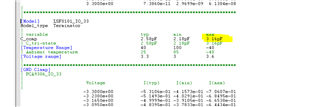

Can you help clarify what this Cio value is? Does this mean that this part has 10.5pF typ load not taking into account the PCB trace loading?
The delay values in the datasheet are given for CL = 15pF, 30pF and 50pF. Is this value taking into consideration Cio on/off values?
In the IBIS model, the series-switch C_comp value is 0.
I want to calculate the total CL seen by this part. Should I be using only the PCB loading or do I need to add PCB+LSF part loading?
