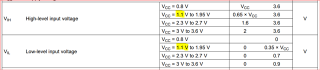

Can you please share your insights about SN74AUP1G126 operating with Vcc of 1.05(+/-0.05)Vcc:

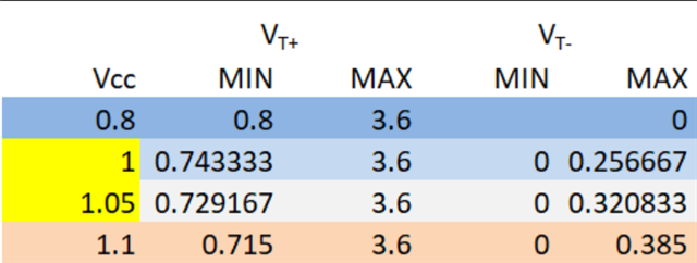

I am actually concerned with the VIL and VIH of this device. With the given Vcc and its tolerance, since the VIL/VIH is dependent on the VCC, as per datasheet records and using interpolations (as guided HERE), I come up with the following:
So, there would be different VIH(min) and VIL(max).
Question:
Is it recommended to operate the device with such Vcc (including the 0.05V tolerance)?
