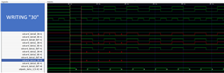

So I started probing the signals of my SD card. First using the Integrated Logic Analyzer (ILA) from my FPGA and I got these results (see pictures)
When I am writing "30" there is no problem on the data channels ("1100" = 3 and  "0000" = 0). However when I am reading the pin sdcard_data2_IN who should be low is high and is giving the FPGA wrong values.

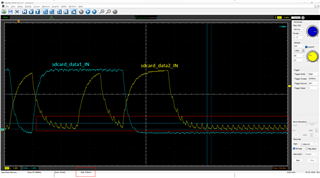

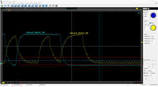

Then I put probes on the 3.3V side and I observed that sdcard_data2_IN has some noises see pictures.
The noise has a frequency of 50 MHz and a peak voltage of 329 mV. With these measures, I am certain that sdcard_data0/1/3_IN are stable but the problem comes from sdcard_data2_IN.

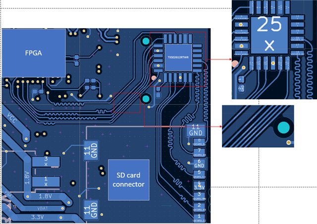

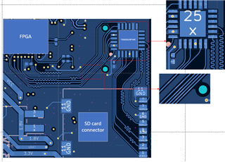

I am sure that my traces are correct for the sdcard. They have a width of 0.09mm a spacing of 0.1 mm. The clock of the sdcard has a spacing of 0.4 mm in order to isolate it from the others signals. They also have the same length matching, and impedance. You can find below my schematic and routing.

    The noise having a specified frequency makes me think that it could be a potential crosstalk issue with signals nearby. Are there any 50MHz signal traces not shown in the snippet of the layout? The signal also appears to have a slow rise time, similar to an RC curve that seems like its related to a loading issue as well. How long are the traces from FPGA to TXS02612 and from TXS02612 to the SD Card? What is the data rate of the signals of sdcard_data0/1/2/3_IN?

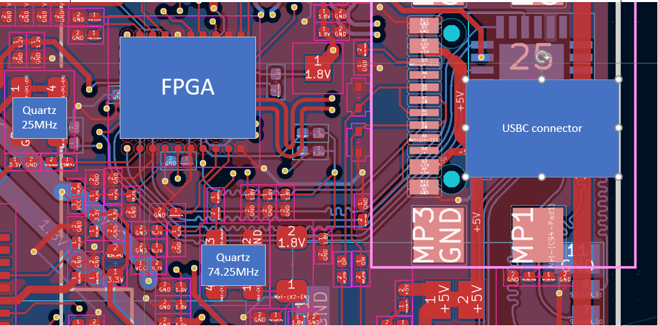

    I don't have any traces with a frequency of 50Mhz, however I do have some quartz oscillator (25MHz and 74.25MHz) and a USB connector on top of the SD card signals. (see pictures top and bottom)
    Concerning the trace length of the SD card from the FPGA to TXS02612 we have 23.23mm and from TXS02612 to SDcard we have 16.60 mm. However, I don't know what is the data rate of the SD card data signals.

    I do suspect that the USBC connector can generate the 50MHz noise on my data line or disturbing the TXS02612 because he is right on top of them, but what do you think can be the cause ?

    With the given info so far, its hard to give a firm answer- though the crosstalk noise goes up to 330mV and can cause a higher VOL at the output of TXS02612 due to the direct dependency the input has on the output as shown in this FAQ. This higher VOL could then be above the VIL max requirement of MCU, resulting in a false logic high. It could be worth disabling/removing the quartz oscillator to see if the crosstalk mitigates. Furthermore, if there are any internal pullups to the MCU, please disable them as to not contend with the internal 40k/4k pullups of the TXS02612.
