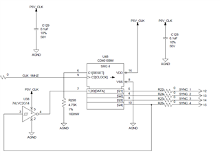

Hello Everyone,
I'm using CD4015B Shift register in my design as shown in the attached image. Pin 9 is connected to 1MHz clock.  For data input, we are giving inverted signal of the Q4.
We had expected a 250kHz pulses in each outputs Q1, Q2, Q3 & Q4. But now I'm getting 125kHz pulses in each outputs.
When I re-calculated it, it shows as 125kHz Only.
Can anyone please look at my design and help me on below my questions.
1. With 1MHz input, what should be the expected output frequency? is it 125kHz or 250kHz? please confirm.
2. If the output is 125kHz, is there any way to generate 250kHz frequency pulses with the same 1MHz input frequency?
