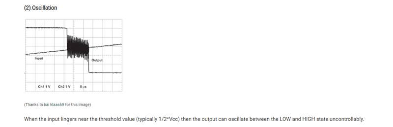

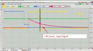

Hi TI Team,
The datasheet specified a maximum rise or fall rate of 5ns/V.
I want to know does the input signal still need to meet this requirement in the case of OE being pulled high and the device being disabled?
In our current design, the input signal may not meet this rate requirement. We would like to confirm whether the risk caused by a slow signal rate can be avoided by disabling the device.
