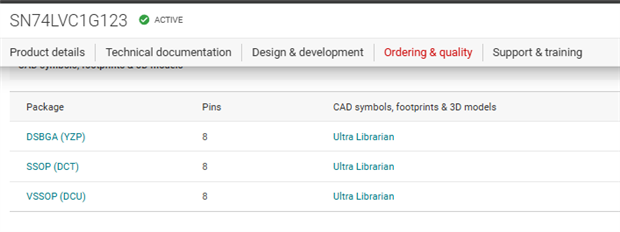

We have problems with the SN74LVC1G123DCK (monostable multivibrator) on some boards. The part is used in the circuit to generate a low pulse of a certain length.
The input signals at the problematic parts are correct, but the low pulse is not generated.
It was noticed that the device marking on the problematic component “CHB” is not given in the data sheet.
Other non-problematic modules have the valid device marking “C23R”.
Is “CHB” still a valid device marking, or may the wrong part have been populated on the board?
