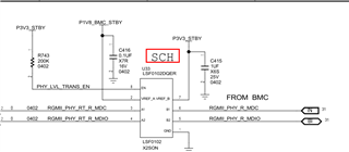

LSF0102: VrefB on the LSF0102DQER.
Part Number: LSF0102
I would like to ask about the usage of VrefB on the LSF0102DQER.
From the datasheet, VrefB and EN are connected together first and then pulled up through a 200K resistor.
In my current design, only EN is pulled up to 3.3V through a 200K resistor, while VrefB is directly shorted to 3.3V. Is this design acceptable?
