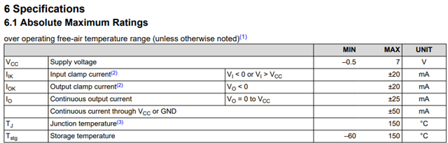

Hello TI guys,
One of my customers is considering using SN74HC04PWR for their new products.
At this moment, they have similar questions with the following tread.
https://e2e.ti.com/support/logic-group/logic/f/logic-forum/1471999/sn74hcu04-maximum-instantaneous-current
Q.
In the device datasheet, the absolute maximum rating of Io is +/-25mA.
Also the absolute max of continuous current trough VCC to GND is +/-50mA.
I think these are in continuous current case.
They'd like to know what the maximum value is in case of 10~20ns pulse signal.
They think the device can flow higher current more than the maximum rating in the pulse width case.
Does TI have any maximum rating data incase of 10~20ns pulse signal?
Or is the value same as continuous output current?
Your reply would be much appreciated.
Kazuya.
  • The answer is exactly the same as in the linked thread.
    The outputs can be connected to capacitive loads of up to 70 pF. For larger capacitances or continuous currents, you have to respect the current limit.
    What is the actual problem you're trying to solve?
