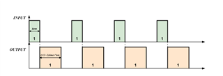

How to produce a square wave with duty=2A and phase=A on TPLD_1202 by inputting a square wave with duty=A?
thanks!

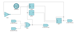

    You can achieve something close using the counter and DFF. See the below circuit on TPLD1202:
    I've attached the circuit to this message.
    https://e2e.ti.com/cfs-file/__key/communityserver-discussions-components-files/151/3058.pulsething.syscfg
    Malcolm
  • Hi Malcolm,
    Thank you for your reply! But can the rising edge I need to output correspond to the falling edge of the input, and also generate a square wave with duty=1.5 * A?
  • Hi f j,
    You can probably achieve this but it will be a little more difficult.
    Malcolm

  • Hi Malcolm,
    Thank you very much for your reply. We do not want to use I2C to control the output duty cycle in real time. If the above logic is difficult to implement, is there a way to implement the following logic:
    1,input duty<1/3:
    2,input duty = 1/3:
    3, 1/3 <duty < 1:

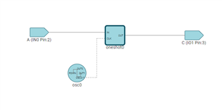

  • Hi fj,
    If you know how long ton is, you can just use a oneshot and appropriate input clock frequency. Example:
     https://e2e.ti.com/cfs-file/__key/communityserver-discussions-components-files/151/pulse2.syscfg

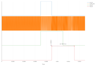

  • Hi Malcolm,
    The duty cycle of the input signal is variable, and the duty cycle of the output signal needs to change along with it. The maximum duty cycle of the output signal is twice that of the input signal, while the output duty cycle of this device is fixed, which is different from my requirements. And when the input signal is high, the output signal must be low, and the above solution does not meet this requirement. You can refer to my previous question for requirements

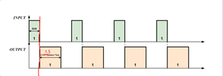

  • fj,
    How close to the falling edge of the signal does the output need to be? Does it matter if there is some space between the falling edge of the input and the rising edge of the output, for example ~200us? A DFF can be used to phase shift the output, but otherwise I'm finding it difficult to meet the requirement that the output starts at the falling edge.
    Malcolm

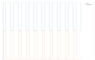

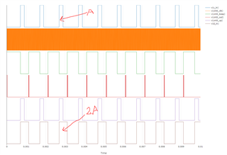

    Try this circuit. I duplicated it and added some extra logic. Maybe this is what you did earlier. You just need to adjust counter data and clock speed to get the duty cycle you want. Here is an example simulation:
    Yes, the output pulse width is very slightly longer than 2A (by 7us, or about 7 clock cycles because of how the counters work). Basically, the output pulse will always be ~3.5% longer than 2A (i.e. final output will always be 2.035A). Hopefully this is margin is ok with your specifications. If it is not, then I do not see a good way to achieve this with TPLD. There's always going to be a slight delay
    https://e2e.ti.com/cfs-file/__key/communityserver-discussions-components-files/151/pulsefalling.syscfg
    For you other scenario with duty cycle <1/3, =1/3, >1/3, we can achieve this, but it's going to be similar where the end pulse width is always slightly longer than you want it to be.
