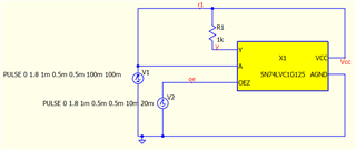

  • Hi Albert,
    Thank you very much for your double checking.
    I think correct operation of SN74LVC1G125 is the follow.
    /OE = 0: Y = A
    /OE = 1: Y = HI-Z
    I attached my schematic and waveform.
    In my simulation, Y= low level not Hi-Z when /OE = 1.
    Could you please take a look the attached file?
    Your reply would be much appreciated.
    Thank you again and best regards,
    Kazuya.

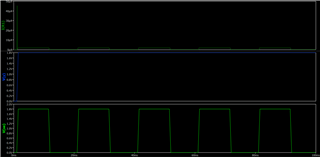

  • Hi Kazuya,
    Very sorry, you are correct I typed out the /OE pin wrong, but I tested it the correct way. Please see my below graphs.
    When I test it out V(y) is on at all times and current across R1 is low.
    Do note, this is not in PSPICE, as my license seems to have expired. I am working on getting this refreshed.
    However, different simulators should have the same result. Can you double check if you are using the correct model still?

  • Hi Kazuya,
    I believe the only way for the to be resolved will be on the TI side.
    I will have to make a ticket to update the model and have our modelling team eventually upload the correct model to the PSPICE library. It seems that you cannot locally upload a model to PSPICE, it has to use a model from the library.
    In the mean time, have you tried TINA or QSPICE modelling, since as you can see in my screenshots, in QSPICE, the model does work correctly.
