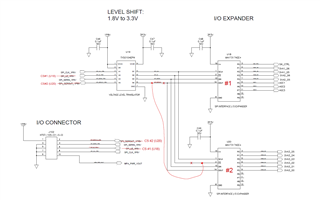

TXS0104E: TXS0104E to MAX7317 SPI 25MHz
Part Number: TXS0104E
Other Parts Discussed in Thread: TXU0104

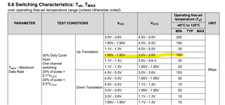

We are currently designing a board that interfaces a TXS0104E to two MAX7317's. The Input to the TXS0104E is SPI lines coming from an I/O connector that's connected through some cabling to the Zedboard PMOD connector (only sclk, cs, and mosi). Signal Integrity of TXS0104E output is not what I expect. I want to confirm if 25MHz is indeed within the bounds of this part. I even reduced it to 20MHz and got similar results. The Zedboard is outputting the SPI lines in push-pull configuration, and IO standard set to LVCMOS33, default slew rate and drive strengths.
This is what the SPI transactions look going into the TXS0104E. Again not the greatest quality, but the output is definitely not the same.
Output of TXS0104E (TXS Input supply sourced from Zedboard PMOD 3.3V)
Output of TXS0104E (TXS Input supply sourced from bench supply 2.8V)
