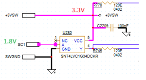

SN74LVC1G34: SN74LVC1G34 powered by 3.3V supply with 1.8V input signal
Part Number: SN74LVC1G34
Other Parts Discussed in Thread: SN74LV1T34
Initially I was using SN74LV1T34 (that can work with 1.8V input and 3.3V supply) but switched to SN74LVC1G34 for higher output current.
Recommended Vih is 2V, but the device still works for some reason with 1.8V input, any ideas ?
