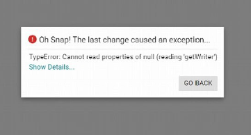

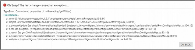

Hi team,
 [Observed Malfunction]
After starting the PC, the first write operation completes successfully, but from the second attempt onward, the application either freezes or displays an error message.
Once this issue occurs, write operations cannot be performed again unless the PC is restarted.
 [InterConnect Studio Version]
1.5.1_1087
[Screenshots of Error Occurrence]
  1. Screen showing the application freezing during the write process
2. Screen displaying the “Oh Snap!” error message
3. Screen showing detailed error information
The driver updates and firmware upgrades have already been completed.

  • Hi Kyohei,
    We were able to reproduce the bug, and I was able to confirm this only happens with TPLD1202 devices. It seems the programmer is reaching a state that when trying to overwrite the program causes it to not be able to write to the device the second time. This is exacerbated by a bug where our read timeout is failing causing the user to be stuck forever.
    A simpler fix than restarting the computer is simply disconnecting and reconnecting the programmer. This will cause the current run to fail, but the next subsequent run will succeed. We will look for fixes, and I will let you know if an updated firmware is released that solves this issue.

  • Has there been any progress on this matter? The evaluation seems to be on hold on the customer side, so could you please check?
  • Hi Kyohei,
    We have an updated firmware version that fixes the initial issue we are planning to ship out alongside the updated InterConnect Studio on Tuesday. This version will not allow for configurations of the TPLD1202, but they can update the firmware with the latest FW version of the programmer, and then reutnr to version 1.5.1 of InterConnect Studio.
    They can also update themselves following the instructions Firmware Update Issue 1.docxTPLD 1.0.0 BSL Batch File.zip
    If the device is no longer reachable I would look into device manager to see if it is still being recognized as
    Or if it has already entered into a device firmware update mode.
    Owen

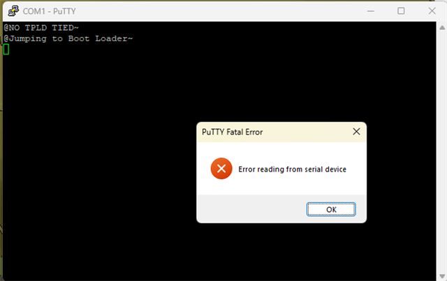

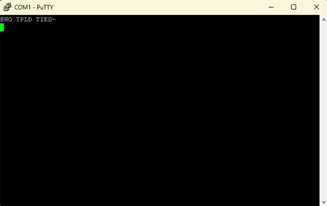

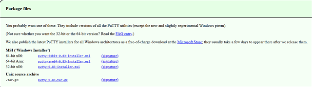

  • Hi Kyohei,
    a. Download puTTY
    from https://www.chiark.greenend.org.uk/~sgtatham/putty/latest.html

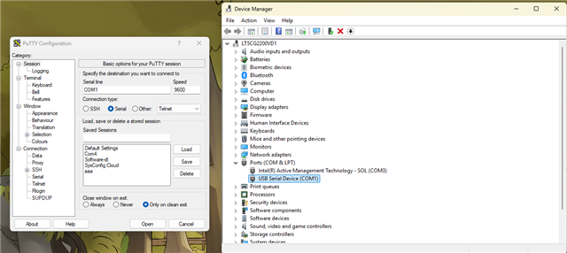

    b. Open the correct Serial/COM port
    If the device is not detected as a USB serial device (COM#)
    Check for something labeled firmware update device. If the firmware update device is there these steps can be skipped.
    c. Enter & ensure programmer communication
    I press "&" on my keyboard with the terminal open. and receive from the programmer
    d. Enter b
    I press "b" on my keyboard with the terminal open. and receive from the programmer
    Once I disconnect the programmer and reconnect it my device manager shows
    Showing the next steps can be executed.

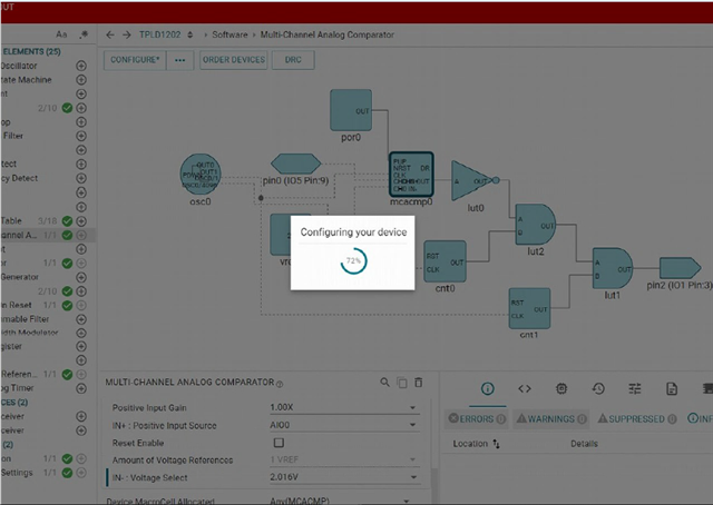

    After confirming with the customer, they completed the firmware update. As a result, the COM port is now recognized. However, during the writing process using TPLD-PROGRAM, the configuration stops progressing at around 72%, and the system becomes unresponsive.
    Currently, they are evaluating the TPLD1202, but suspecting a device dependency on the EVM, we attempted writing to the TPLD2001EVM. In this case, the configuration completed successfully, but the behavior of the device differs from what was written, indicating that the writing process did not work correctly.
