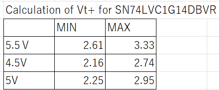

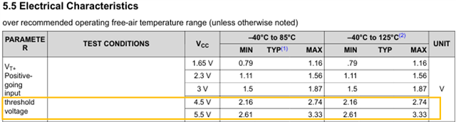

I am reviewing the datasheet for SN74LVC1G14DBVR and noticed that the value of VT​+ is only provided for specific VCC values (e.g., 4.5V, 5.5V).
For my application with a 5.0V supply,I attempted to estimate VT​+ by linearly interpolating between the 4.5V and 5.5V data points:
Questions:
Is this linear approximation method correct for estimating VT​+ at 5.0V?
