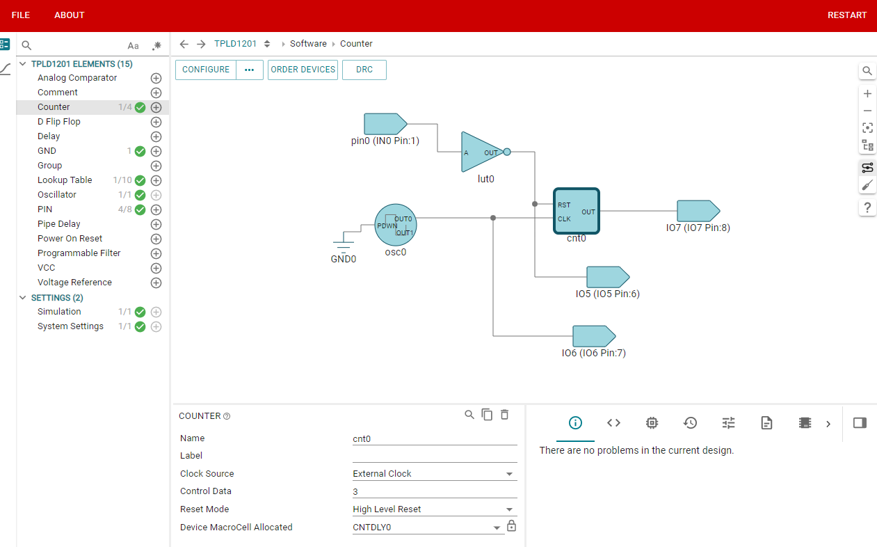

image.png with TPLD1201, EVM

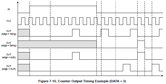

First, I understand the CNTDLY starts with output L. Actually,
Configured TPLD1201 outputs L from startup: (IO7 = OUTPUT)
But ICS simulation output H:

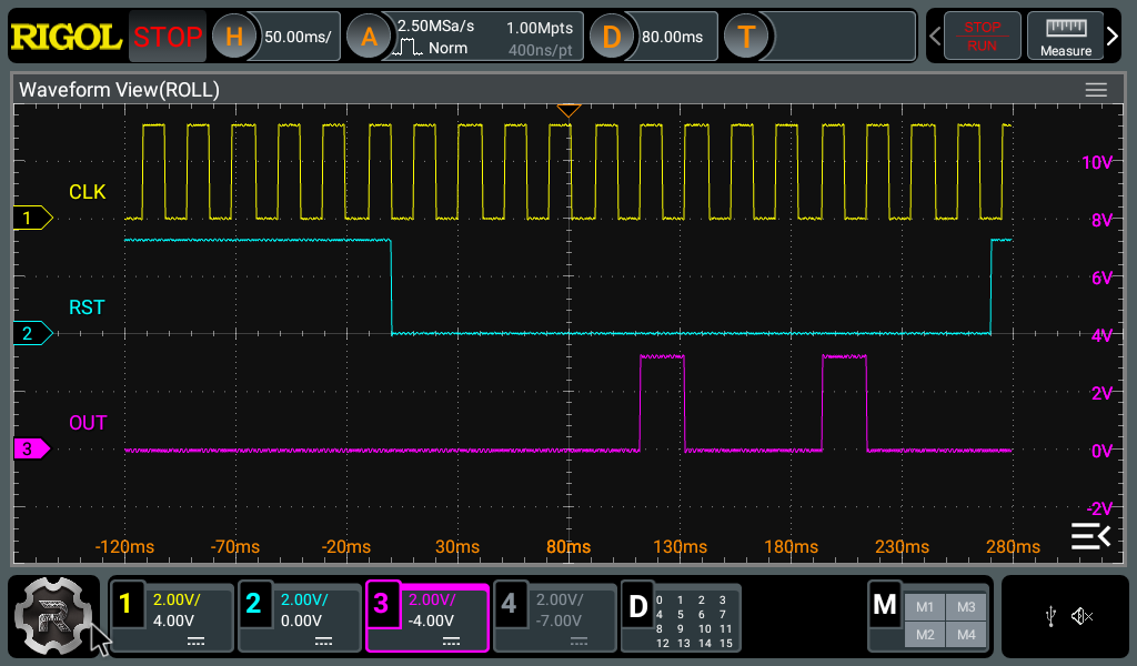

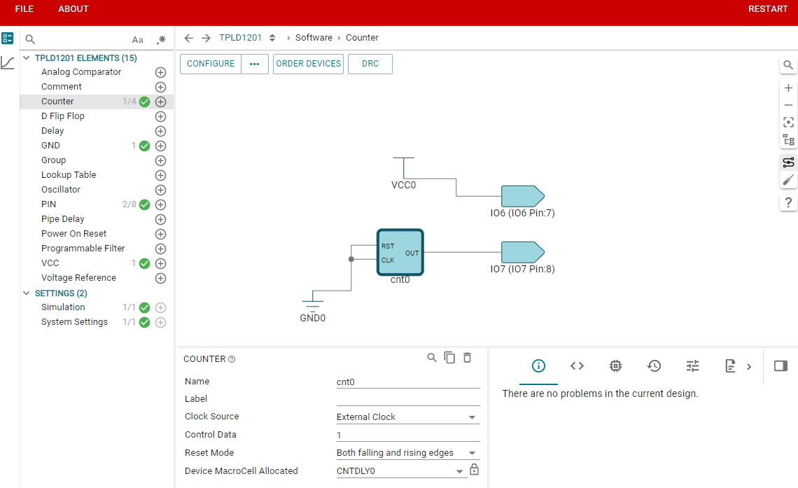

Second, when RST set H level and, during reset and release time expects output = L.
Configured TPLD1201 (with count=3) also works normally:

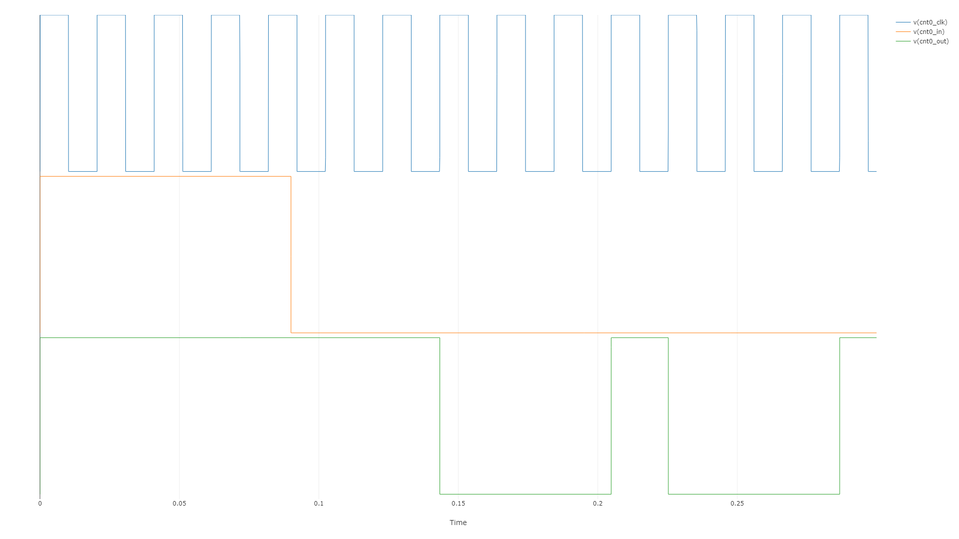

Again, ICS simulator doesn't so:
I think this issue is same between datasheet and configured TPLD, and only ICS sim is wrong. Is it true?
