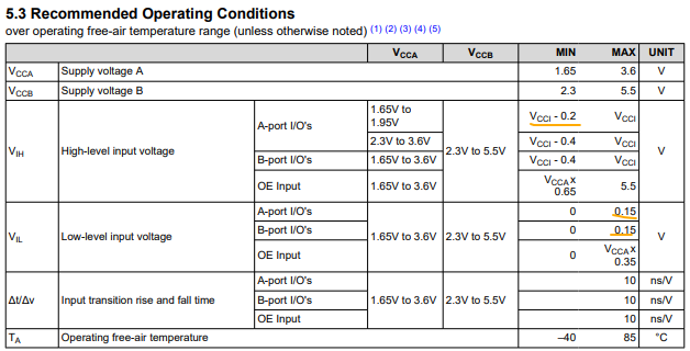

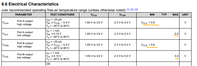

Planning to use Level translator for MDC and MDIO line having phy side (VCCA 1.8v) and (VCCB 3.3v).If we consider datasheet value for VOL,VIL,VIH,VIL then VOH,VIH,VIL, it is  failing at PHY side.Attaching the datasheet snip.

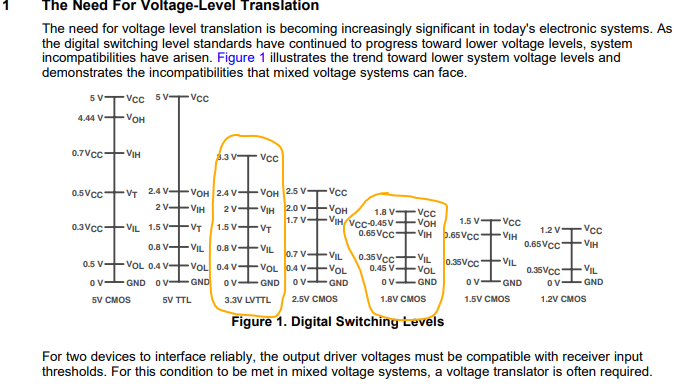

But there is a guide documnet for TXS series translators and there we have different value for VOH,VOL,VIL,VIH. With thses guide doc, DC analysis is getting passed for all.Attaching the snip and link for reference.  GUIDE DOC LINK
Please clarify which one to consider for DC analysis?
