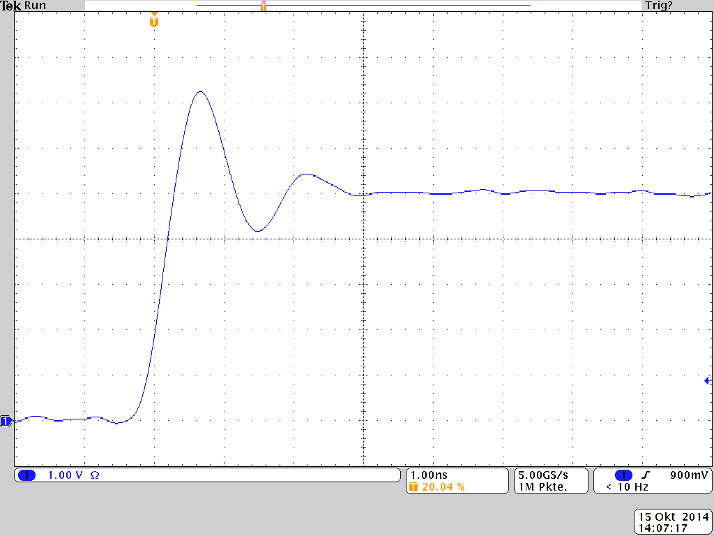

I have a direct connectuib if a LVC schmitt Trigger (74LVC2G17) to a LVC OR-gate (74LVC1G32).
Both are supplied with 5V (same supply), both have a 10nF buffer cap at its supply Pins (very Close) and they are places very close together on a pcb (Output to Input <7mm)
When i measure the Signal at the OR-Input, i see a overshoot of up to 7V.
I measure with an 1.5GHz active probe with very short wires (<10mm) between the OR Input and the buffer cap GND.
The Absolute Maximum of the Input is 6.5V. With the overshoot, i exceed this Limit every time (it is a CLK-Signal).
Is the Input capable of withstanding the overshoot?
Is it mandatory to implement a line resistor in the Output (on costs of space...)?
Or are there any other possibilities to prevent the overshoot?

    It is allowed to have 1V above or below absolute max for less than 10ns. So you are OK
    I would recomend getting rid of the spkie if possible but if not then it is OK.
    LVC devices are very strong drivers at 5V and the inputs ar very light loads and the combination of strong drive an light load will cause overshoot and undershoot. To reduce the spike you could use a series resistor or use a capacitve or resistive load to gnd.

    The LVC logic devices have high current drive. There are a few options here:
    1. The most practical option would be to try a 50-ohm series resistor on the output of the first LVC device to slow down the output signal and dampen the overshoot.
    2. You can try replacing the LVC2G17 with a SN74AUP2G17, which has a much lower drive strength of 4 mA.
    It's possible that the device may be able to withstand small periods of voltage higher than absolute maximum, but we strongly advise against this, as behavior across multiple devices may be unpredictable and it would be operating outside of safe datasheet limits.

    I wanted to avoid modifying a series resistor into my short line or put an additional (capacitive or resistive) load to it. Its also a question of space and cost because i would need to change the layout...
    I will search if i find another part with less drive strength in our system with less drive strength and check the Signal again.
    My overshoot is much less than 10ns so if i dont find another solution i may try to live with it.
