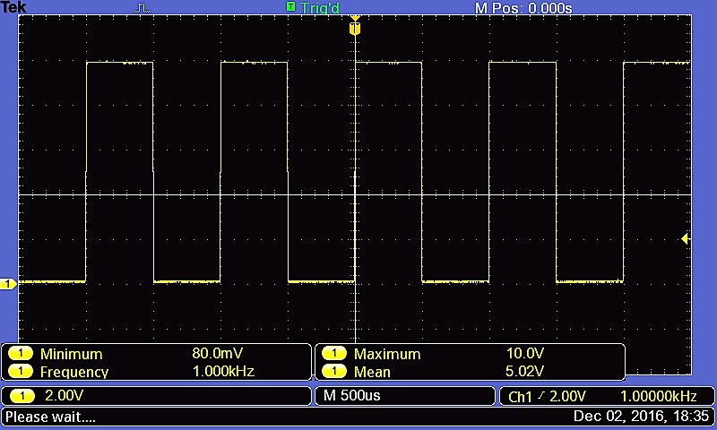

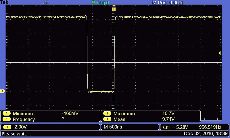

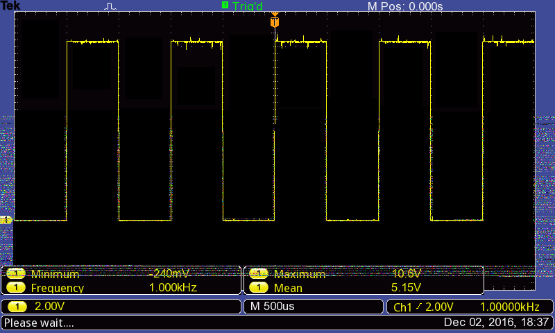

    Hi thank you for the interest, before going on with LV4046 (I have ordered a new one on RS since a colleague of mine got all the others burnt in a prototype a multiline clock structure), please have a look at these signal obtained using as a reference the frequency multiplier in the application note scha002a.
    Consider PCP_OUT it should be constant while at every new period of SIG_IN I have a signal of loss of lock (variable in duration, i.e. not at steady state) which is also reflected in VCO_OUT see video.
    While waiting from new LV4046 (hoping that my boss will buy new ones) I am considering TI's CD4046, as far as I know the PCP_OUT should be constant or at least showing a steady-state error, i.e. fixed phase errors between SIG_IN and COMP_IN, not a COMP_IN signal moving around SIG_IN because that means the PLL is not in lock in a stable condition.
    Here is SIG_IN (pin 14)
    Here is COMP_IN (pin 3)
    Here is PCP_OUT (pin1)

  • Alberto,
    I just started looking at this also, so forgive my unfamiliarity with this thread.
    Originally you mentioned 50 Hz multiplied by 512 to be 25.6 kHz; Last message shows 1 kHz multiplied by 512 to be 512 kHz.
    As far as I can tell, the loop is locked. PCP_OUT is high almost all the time which means most of the time no correction is needed. However this phase detector only takes action once there is a phase error, otherwise the output is just floating to maintain the status quo. Clearly the VCO voltage will drift a little over time. Once the phase detector sees the drift it produces a 600ns correction pulse indicated by PCPout signal. This correction is not subtle enough so it shows a jump in the oscilloscope display. Probably one jump per correction.
    You could reduce the PC2OUT effect on VCO voltage so that less change per correction pulse occurs. Otherwise chose one of the other phase detectors that output a signal every input cycle. This might spread the jitter out to every pulse instead of widely spaced huge jitter corrections.
