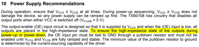

In the datasheet it mentions that the OE signal should be pulled down and should be enabled only after VCCA and VCCB are both stable.  (This seems similar to TXS devices.)
Could we use an RC to delay it slightly to solve this problem?

    The OE pin should only be pulled down if you want to ensure that the device starts in the high-impedance state. Otherwise it can be tied high or connected to a controller directly.
    I would recommend against connecting a standard CMOS input directly to an RC. This will result in excessive current in the input, and can cause oscillations, unexpected behavior, and damage. There's a great applications report on this topic here: Implications of Slow or Floating CMOS Inputs
    If you need a power on reset signal, I would recommend following the suggestions in this short video: Generate a Reset Signal at System Power On

    Regarding the RC circuit: could this be used on the OE pin to cause the I/O pins to remain Hi-Z on power up, until both VCC pins are stable?
    Thank you, Keith

    Regarding the RC circuit - I would recommend against connecting a standard CMOS input directly to an RC (ie the OE input). This will result in excessive current in the input, and can cause oscillations, unexpected behavior, and damage. There's a great applications report on this topic that I linked above.
    If you need a power on reset signal, I would recommend following the suggestions in the video I also linked above.
