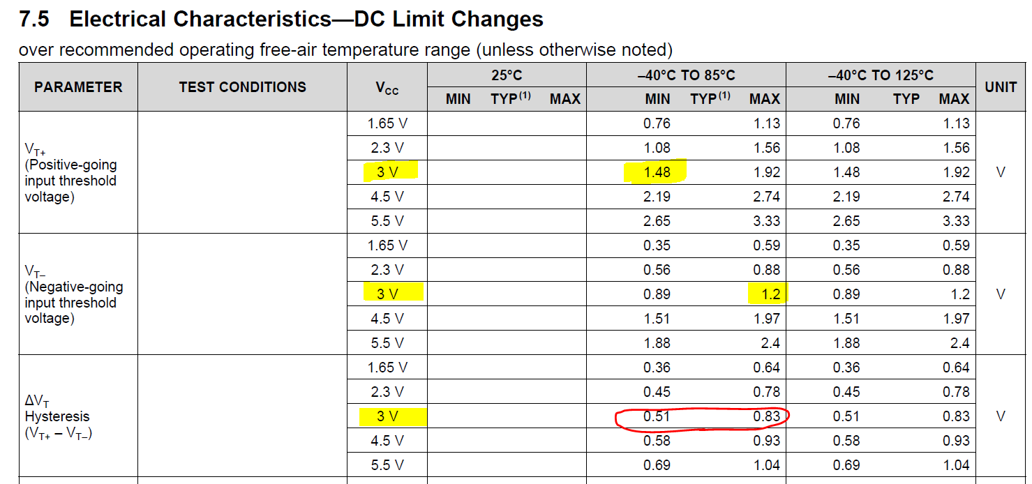

Part Number: SN74LVC1G17
If VCC=3V, when input voltage from low up to 1.48V, then the output will be high voltage as VCC. And input voltage down below 1.2V, then output become low level. The input voltage hysteresis we should check is VT+ and VT-? What's the deltaVt hysteresis mean?
