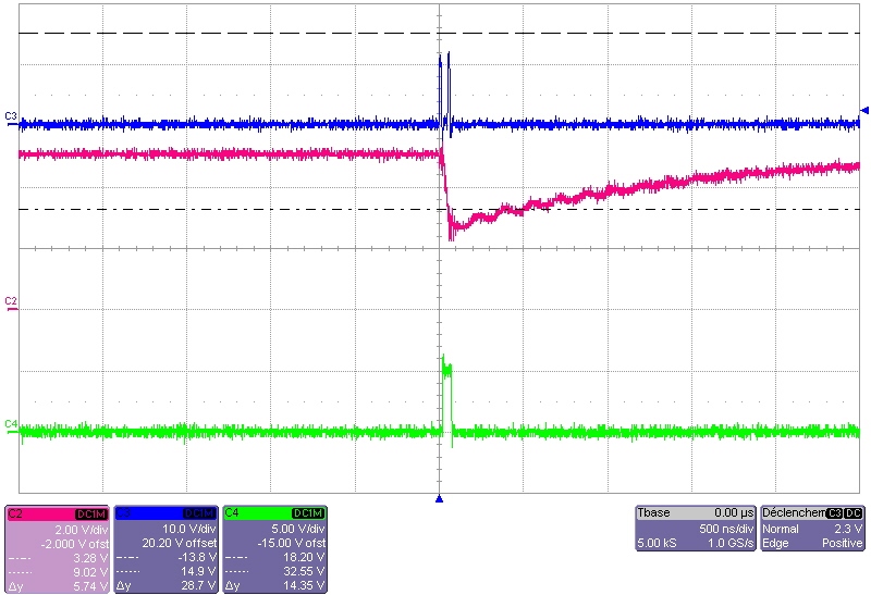

If we have port A low and we pulse the port B a second time during the discharge of the external capacitor, the output pulse is either shorter than expected, or worse just a single very short pulse! We would expect that the second pulse would be ignored (as it is with HEF4528 and stated in your datasheet). We have an RC of 1nF capacitor and 1.5k resistor. As you may see on the fist attached picture (ptm1), we have the second pulse ignored if it arrives after the full discharge of the capacitor. On the second picture (ptm2), we have the second pulse during the discharge of the capacitor, which reduces the length of the output pulse. On picture three (ptm3) it is even worse, because the output pulse length is the difference between the two input pulses. (note : blue trace is input on pin B, purple trace is capacitor on RX/CX pin, green trace is output Q) If a third pulse arrives, it retriggers the monostable!!! Strange situation for a NON-retriggerable monostable. Please note that the input pulses width (~20ns) are larger than the ones specified in your datasheet (min 5ns). In your datasheet it is written: "Once triggered, the outputs are independent of further transitions of the A and B inputs and are a function of the timing components". It is clearly not the case! Our "clear" input is still and not noisy, so it cannot come from this source. Do you have an idea on how to overcome this?

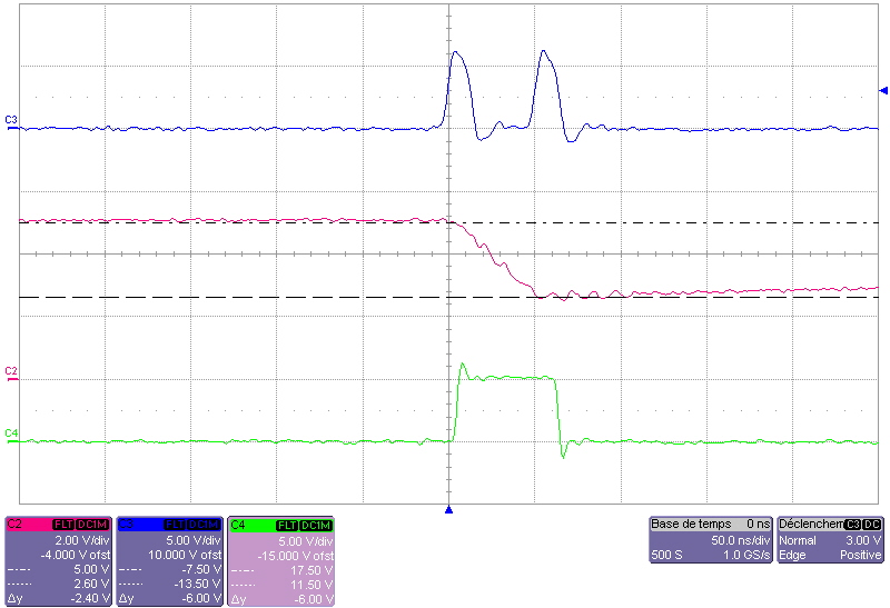

    Welcome to the forum! Can I get the third scope shot (ptm3) zoomed in on the time scale to 50 ns. Can you also put the one of the markers to monitor the purple trace voltage right when the output pulse stops. I want to see a what voltage the causes the output to stop so I can verify if the issue is with the comparator internal to the device.

    Here is a zoom on the signals to 50ns/div. The pulses are 15ns long with 54ns between them. This is the maximum delay between the pulses for this phenomenon to appear. The capacitor discharges to 2.6V only.
    Once I enlarge to 51ns, the pulse is shorter than expected by the RC ratio, but longer than the difference between the two input pulses as shown here.
    C2capa-voltage00000.csv C3input-trig00000.csv
    Just for fun I tried instead of the initial 1nF capacitor and 1.5k resistor, a capacitor of 10nF to see if the capacitor discharges to the same level of 2.6V. It appears that it only discharges to 3.54V only for the phenomenon to appear (see ptm_10nF picture). The pulses here are 26ns long (no influence on the phenomenon) and the time between the two rising edges is 284ns !!!
