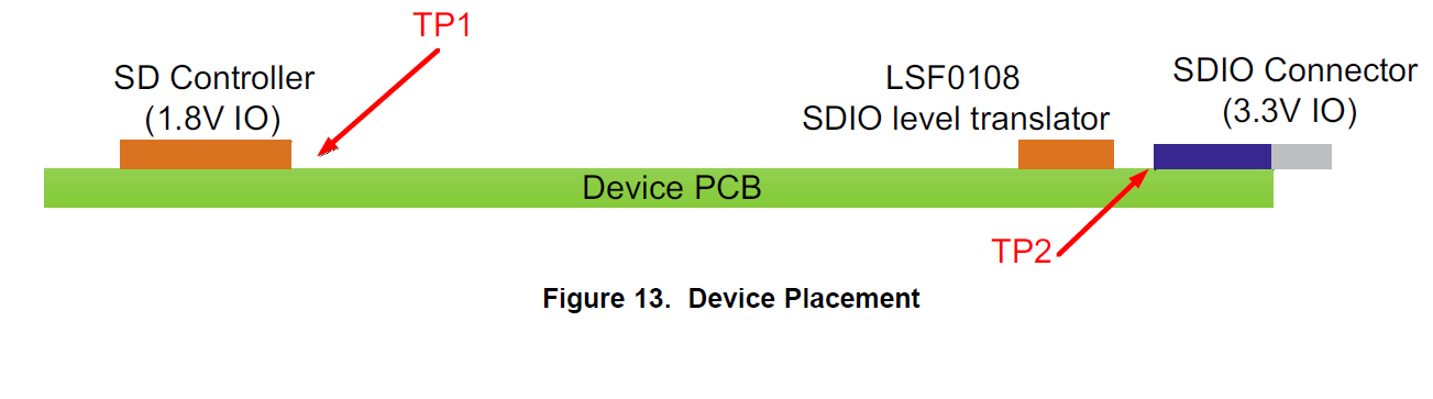

Part Number: LSF0108
1) WHY LSF DEVICE SHOULD BE PLACED AT HIGH VOLTAGE SIDE?
2) SHOULD THE PULL UP BE PLACED CLOSED TO LSF DEVICE ?
I am not clear on your first question. Can you specify what you mean?
2. The LSF device is a passive translator. It doesn't have any drive strengths. The placement of the pullup resistor doesn't matter that much. It is however recommended to keep the trace lengths as short as possible. Here is a whole series on the LSF devices we have created. I recommend you watch entire series as it is very short.
Thanks!
-Karan
Hi Karthik,
Placing close to the target device limits the trace length, which in turn reduces the parasitic capacitive loading on the LSF outputs. As mentioned already, the LSF is a passive translator device which depends on the external pullup resistors to achieve level translation. With higher loading, the transition time ( RC time) will be longer and will limit the max operating frequency the LSF can support. The layout section is a guideline but not a requirement.
The longer the trace length, the higher the cap loading, lower the freq support or lower resistor required for supporting the same freq.
