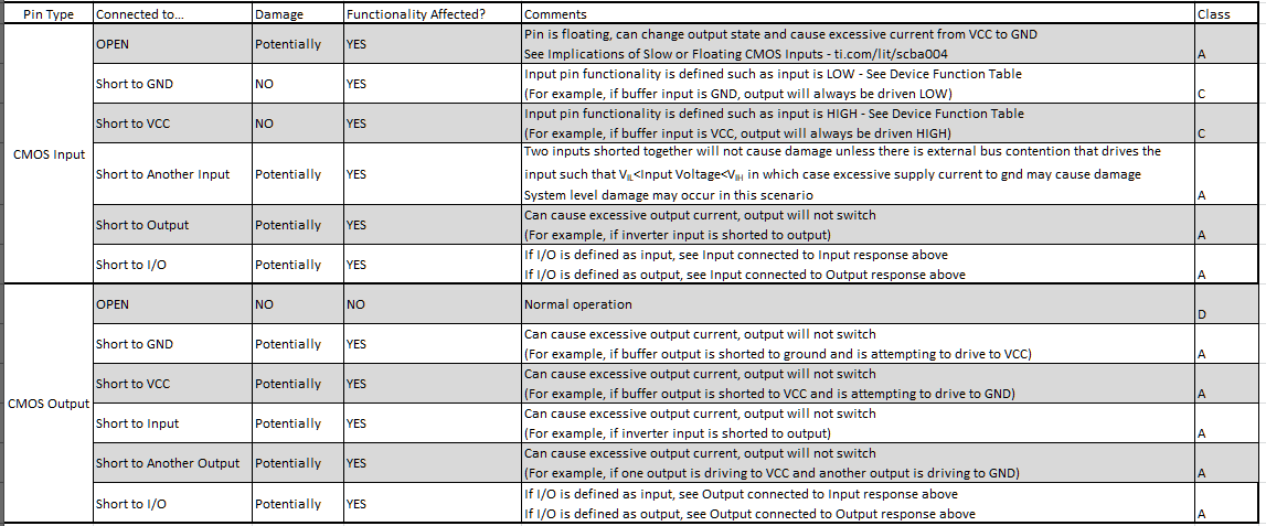

  • Hi Tobias,
    This table should help with most of these.
    For question 4, with one input tied high it effectively makes it a buffer. So if the input is unknown, the output is also unknown. Its advised not to leave inputs floating see this FAQ:https://e2e.ti.com/support/logic/f/151/t/737694

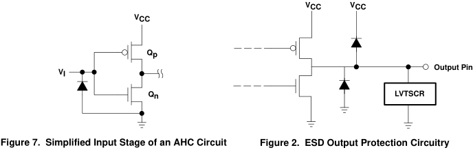

  • 1. If GND is open, then the chip's internal ground might still be pulled low through the ESD diode at any input or output pin, if that pin has a low voltage applied.
    2. If VCC is open, then the chip's internal VCC might still be pulled high through the ESD diode at any output pin, if that pin has a high voltage applied.
    3. If VCC = 0 V, then the chip is powered off. The inputs are overvoltage tolerant, i.e., it is allowed to apply voltages to any input.
    4. A floating input pin might damage the device. See [FAQ] How does a slow or floating input affect a CMOS device?

  • When there is no voltage applied to an output, then the chip cannot be powered through this output.
    When VCC = 0 V, then any voltage larger than about 0.5 V at an output causes a current to flow into VCC.
