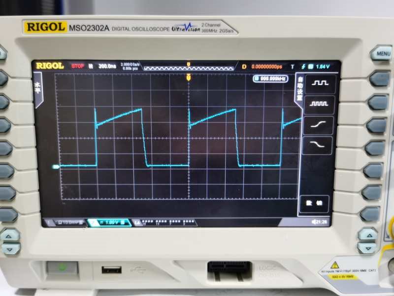

TXB0108: waveform of 5V level-up output
Part Number: TXB0108
Other Parts Discussed in Thread: SN74LVC8T245, SN74AHCT541
Hi there,
My customer is using TXB0108 to level-up 3.3V to 5V. And I see the output is as below figure. I think it is because the capability to drive apacitive loads is limited, so should I recommend them to switch to SN74AXC8T245 ?
Thanks.
  • Yes, a load that is too large looks like this.
    If the signals are unidirectional, a direction-controlled translator like the SN74LVC8T245 will work much better. (AXC does not go above 3.3 V.) But for 3.3 V → 5 V translation, you could simply use a buffer with TTL-compatible inputs, such as the SN74AHCT541.
