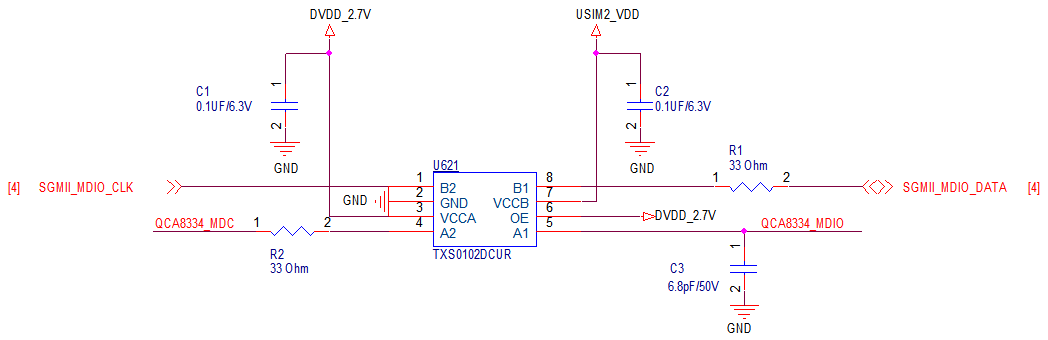

Our customer has an LTE module with a 2.85V MDIO bus, needs to interface to a pair of 2.7V powered MDIO slave devices, MDC = 6.25MHz.
About the maximum data rate of this part, the datasheet says the following: 24Mbps for push-pull and 2Mbps for open-drain.
Below is our circuit, any issue using TXS0102 in this scenario? (ex. MDC = 6.25MHz)
  • Do the master and the two slaves drive the MDIO signals with push/pull drivers or with open-drain drivers?
    (A difference of 0.15 V should not require a level translator.)
  • In our product, the master is the LTE module and the slave is QCA8334 only. Both drive the MDIO signals with open-drain drives.
    Does it mean that the maximum data rate depends on the master or slave?
    (if the master or slave is with open-drain drives the maximum data rate for 2Mbps, and with push-pull drives for 24Mbps, right?)
  • The data line is bidirectional. The limit is 2 Mbps if any device uses open-drain drivers.
    Why don't you connect them directly, without a level shifter?
  • Because the recommended operating conditions of QCA8334 slave is 2.83V (max), and the master output signal is at least 2.85V.
    It's my understanding that the clock line of an MDIO (typically called MDC) signal is a push-pull driver and is unidirectional, while the data line (typically called MDIO) is bidirectional and open-drain.
    If this is the case, then there shouldn't be any problems for the MDC signal. The MDIO signal will probably not function correctly though, since it is likely operating at a similar speed and is open-drain.
    I would recommend against having series resistors at the output of the translator - this device uses a series switch internally and adding resistance will only reduce performance / cause V_OL to drift upwards.
    If the TXS translator is to be used, I would recommend limiting the MDIO speed to 2 Mbps, which likely means reducing the clock frequency to 2 Mbps.
    I would agree with Clemens that there is probably no need for the translator in this case. I would recommend contacting the manufacturer of the device to find out if it can support a 20mV input voltage increase above recommended max.
