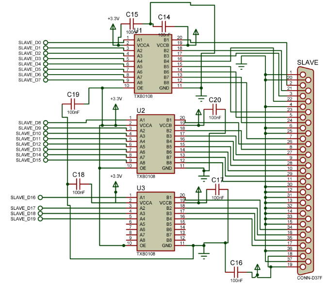

TXB0108: output signal in 5v side not as prospected
Part Number: TXB0108
Other Parts Discussed in Thread: SN74LVC8T245, TXS0108E, SN74LXC8T245, SN74AXC8T245
Hello
i want to connect 5V devices with 3.3V FPGA IO , i have used TXB0108 and TXS0108 for level translation.
The output signal is always 2V constant voltage with noise.  instead the original signal with amplitude of 5V.
The OE is connected to 3.3V (VCCA or controlled by FPGA 3.3V).
