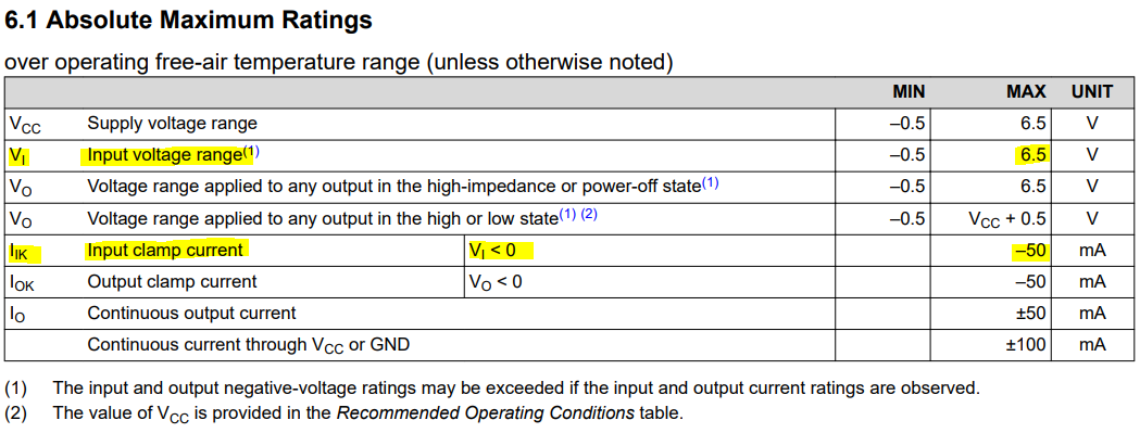

So this part SN74LVC1G17, does it have a positive clamp diode at the input ? Wil the 5V input flow into the Vcc rail ?

Yes, as I said at the start, the device has over-voltage tolerant inputs. This means that there is no input clamp diode and current will not flow from the input to the Vcc pin.

Thanks for the input. We are working to add explicit statement of the clamp diode placements for all released datasheets going forward, but older datasheets like this one may take a long time to be updated. In the meantime, the FAQ I provided explains how to determine this in detail for any device.
Although the datasheet doesn't use the words "positive clamp diode," it does include specs that identify the existence of the diode in both the absolute maximum ratings table and the recommended operating conditions tables.
The input voltage range (first highlight) does not indicate a dependence of input voltage on VCC (max), which means there's no positive clamp diode. This is confirmed by the Input clamp current (clamp meaning clamp diode), which only shows activating the clamp diode when the input voltage is less than 0V -- thus indicating only a negative side diode.
Double checking in the recommended operating conditions table, we can see the input voltage repeated with no dependence on VCC:
