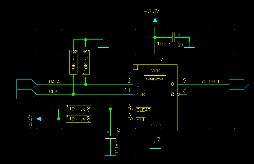

SN74LVC74A: Q output state after power up.
Part Number: SN74LVC7Hello,
Other Parts Discussed in Thread: SN74LVC1G17
Could I use an RC circuit on the /CLR pin?
I saw that in the datasheet that the input transition rise and fall time should be in 10ns/V. But I dont understand what it  will be the issue on this asynchronous pin.
Moreover, this "slow transition" on /CLR pin will only occurs at each powerup.
if  not, Do you have you a solution to be sure that Q output is at logic level "0" after power up.(I can't use  SN74HCS74).
Best Regards.
