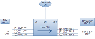

The Level Shift chip is used as a switch function. It is enabled by controlling EN to cut off or connect to UART communication.
(1) VL is powered by a separate LDO1, the level is 1.8V, and the signal on the VL side is 1.8V UART signals of two different ICs;
(2) VCC is powered by another separate LDO2, the level is 1.8V or 3.3V, and the signal on the VCC side is a 1.8V UART or a 3.3V UART;
(3) Because the UART signals of two different ICs need to be controlled, the IO power corresponding to the UART is not used as a reference level, but a separate LDO1 and LDO2 are used to provide a reference to ensure that the level is standard 1.8V or 3.3V.
(4) EN uses a separate 1.8V level enable, which may come from 5V or other voltage divisions. EN remains low for a long time. When UART communication is to be used, 1.8V enable level is provided.
