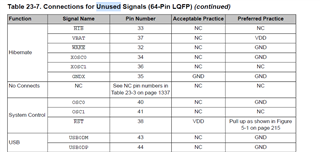

    apart from above attachment while doing schematic i had following doubts
    1. Is it advised to tie the JTAG Reset to Actual Reset of Tiva ?
    2. I am not trying to put the Tiva in to Hibernation modes, so i have left it open, what to do with un-used ?
    3. I have followed the decoupling caps as used in the launch pad, hope they should be fine
    4. Confirm on the JTAG Header part, i am using xds200 probe, i have gone through multiple threads but could not find exact information of footprint numbering suggested for PCB Header and also i could not find exact pinout of xds200 wire header.
    5. Mainly i am skeptical on my JTAG wiring for connecting XDS200, kindly confirm it.
    6. last but very important doubt is maximum current consumption by VDD3V3 rail of MCU, from data sheet i can understand it to be 60mA, correct me if i am wrong, so 400mA regulator used on launch pad should be sufficient.
  • 1. Is it advised to tie the JTAG Reset to Actual Reset of Tiva ?
    1. That is up to you. I have seen people done that.
    2. Which pins are your talking about? Please reference the unused pins section in the datasheet.
    3. it should be fine if you follow the LP schematic. Please also reference the TM4C123 system design guideline. https://www.ti.com/lit/pdf/spma059
    4. This app note should help. https://www.ti.com/lit/pdf/spma075
    5. Please see above app note in section 3.2 table 2.
    6. Yes, 400mA regulator will be enough. Please also take into account other components on your board sourcing from the same regulator.
