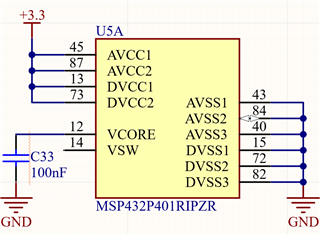

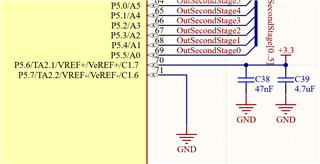

Good day everybody,
I have a problem that occurred after programming my board once. In this first instance it was possible to download the software onto the MCU, at least no error was shown during programming. The first error was that during the debugging session, CCS stated that there is no feedback form the MCU.
After trying to reprogram the device, I get the following error:
Error connecting to the target:
(Error -261 @ 0x0)
Invalid response was received from the XDS110.
(Emulation package 9.3.0.00042)
The JTAG Connection test is valid and returns no error.
Sadly the VCORE voltage is at 63.8 mV what also shouldn't be the case, right?
Here my schematic:
I am happy about any input. All the best
Aaron
