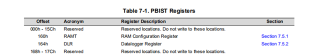

    3.In register list(the photo1),STR is a resvd register, and couldn't be writen. But in the example context(the photo2), it can be writen to resume self-test. It's inconsistent, which one is true?

    I mentioned before. STR register is reserved. Resume test without fixing the issue will not clear the error flag. If you want to try the RESUME, please write 0x2 to this address (offset is 0x16C). When the 0x02 to this address, the test is resumed.
