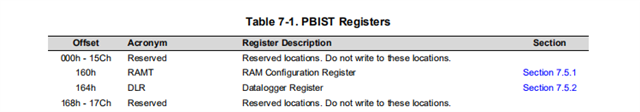

3.In register list(the photo1),STR is a resvd register, and couldn't be writen. But in the example context(the photo2), it can be writen to resume self-test. It's inconsistent, which one is true?

    3. You can write 0x2 to this reserved register, but the readback data from this reserved register may not be the same as the written value.
